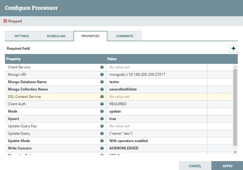

I am running into some serious JSON validation errors, which is not really needed when I am trying to insert records into MongoDB, which expects "Extended JSON". This is when I am trying to use PutMongo Processor!
Here is the scenario:
I have a input CSV like this:
bpno,age,ordered
1234,12,"24.10.2017"
Through a series of processors, i got it formatted to the shape that is as expected by MongoDB update statement.
{$set: {"createdon": ISODate("2017-03-03"),"bpno": "1234","age":"12","ordered":"xyz"}}
PutMongo is failing to update this statement, because ISODate is not complying to Standard JSON! (com.mongodb.util.JSONParseException) I have reached a dead end here, due to this!
Is there a way we can relax this insert this record with Date field?
Any solution or alternate approach, is really appreciated!
Here is the screenshot of PutMongo
(PS: PutMongoRecord works fine, when we use appropriate AVRO schema, with date annotation. In my case mentioned above, i need to do an update, hence using PutMongo)

try this
"createdon" : {
"$date" : "putInHereDate"
instead of
you can solve this also via JOLT
