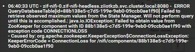

Hi guys! In the QueryDatabaseTable processor configuration, the Maximum-value Columns parameter specifies a column from the database table. The database polling frequency is 5 seconds, but it happens that new data in the table does not have time to appear after 5 seconds and probably due to this the following error appears, but the processor is working and when data appears, it takes it, but this error annoying, can it be avoided somehow?

The problem you are reporting is not related to the database and how it works, but to how you configured your NiFi Instance and especially your ZooKeeper.
First of all, are you using embedded Zookeeper or external Zookeeper ? Did you configure the state-management.xml file and the nifi.properties file with the correct connection string for your Zookeeper nodes?
Secondly, when using NiFi in a cluster manner, the Zookeeper is used to maintain the state of some processors within the entire cluster, meaning that those processors will try and attempt to use the state manager, even though it was not configured -- or in your case not configured correctly.
So what I suggest you to do is check the zookeeper configurations from within NiFi. Next, set you processor on debug and check if NodeX is able to retrieve the state using the ZK and so on. Maybe you have a connectivity issue from a specific node.
