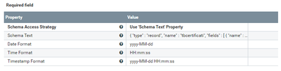

The putKudu processor is as following:
Validation record always fails, and if trying to directly insert the record with the PutKudu processor, I get the error:
Failed to write due to Can't set primary key column foo to null : java.land.IllegalArgumentException: Can't set primary key column num_caso to null
I have trying capitalizing/decapitalizing the field names, with no success. The field clearly has a value associated to it, I don't understand why it is said to be null.
