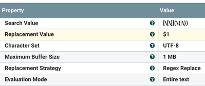

The following configuration of ReplaceText should work for you:
where the Search Value is the following:
This matches [{ or ]} (and also [} and ]{ which shouldn't show up if your input is valid JSON) and replaces it with whichever curly brace it found. Note that this is a fairly specific solution, where the array is the last element of an object (i.e. the end pattern is not the end-of-object followed by end-of-array, rather the reverse).

Master Guru
