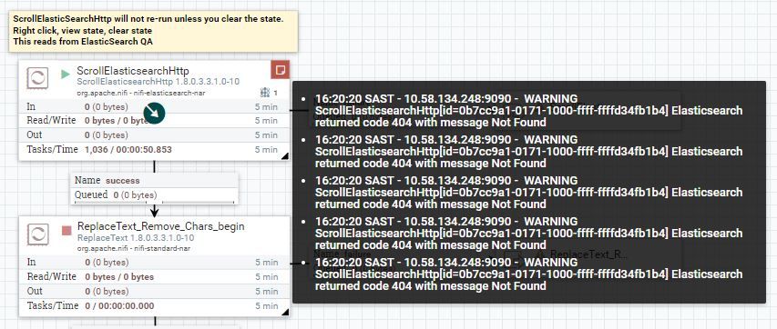

I am using the ScrollElasticsearchHttp NiFi processor to read all messages for a particular set of ElasticSearch indexes which I am then writing into a data warehouse after some processing.  I know that there are about 25 mil records in total in the ElasticSearch indexes.  After reading about 100 000 messages for example, the processor fails with:
ScrollElasticsearchHttp[id=0b7cc9a1-0171-1000-ffff-ffffd34fb1b4] Elasticsearch returned code 404 with message Not Found
I know that this 404 error is temporary/transient because when I query ElasticSearch directly through a browser, it returns content just fine.
e.g. https://10.61.5.38:9200/my-index-name-*/_search?pretty
How do I set the ScrollElasticsearchHttp processor to continue from the scrollid where the failure occurred, rather than clearing the state and starting reading from scratch again?
When I view the state of the ScrollElasticsearchHttp processor, it shows me that it has stopped at a scrollid with a value of:
DnF1ZXJ5VGhlbkZldGNoDAAAAAACYcPvFjhDa3VKV05lUUFXN2NGa2U1b1BQcncAAAAAAmHD7hY4Q2t1SldOZVFBVzdjRmtlNW9QUHJ3AAAAAAFmF00WS0NHRHhVNmZRM0NsLWN2a25tVUxCZwAAAAACkT4ZFmtWSTVoYlFTUzRhczl4R0VNN0RPd2cAAAAAAoSQgBZONWYtLTRjZVI2U0Y2bDUtUk1jbXlBAAAAAAKEkIEWTjVmLS00Y2VSNlNGNmw1LVJNY215QQAAAAABJZsGFjloWnN3VklXUlZxRnhrcUM1MS1USncAAAAAAk400RZWN0V6UFVKY1J6dXdGWHo5WURwSDJ3AAAAAAJONNIWVjdFelBVSmNSenV3Rlh6OVlEcEgydwAAAAABZhdOFktDR0R4VTZmUTNDbC1jdmtubVVMQmcAAAAAApE-GhZrVkk1aGJRU1M0YXM5eEdFTTdET3dnAAAAAABpJsMWaDJMbDZ6YmJSNEdLc3FiX09jMDNlQQ==">DnF1ZXJ5VGhlbkZldGNoDAAAAAACYcPvFjhDa3VKV05lUUFXN2NGa2U1b1BQcncAAAAAAmHD7hY4Q2t1SldOZVFBVzdjRmtlNW9QUHJ3AAAAAAFmF00WS0NHRHhVNmZRM0NsLWN2a25tVUxCZwAAAAACkT4ZFmtWSTVoYlFTUzRhczl4R0VNN0RPd2cAAAAAAoSQgBZONWYtLTRjZVI2U0Y2bDUtUk1jbXlBAAAAAAKEkIEWTjVmLS00Y2VSNlNGNmw1LVJNY215QQAAAAABJZsGFjloWnN3VklXUlZxRnhrcUM1MS1USncAAAAAAk400RZWN0V6UFVKY1J6dXdGWHo5WURwSDJ3AAAAAAJONNIWVjdFelBVSmNSenV3Rlh6OVlEcEgydwAAAAABZhdOFktDR0R4VTZmUTNDbC1jdmtubVVMQmcAAAAAApE-GhZrVkk1aGJRU1M0YXM5eEdFTTdET3dnAAAAAABpJsMWaDJMbDZ6YmJSNEdLc3FiX09jMDNlQQ==

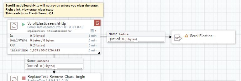

In a recent Use Case of NiFi + ELK, we route all failures for ELK Processors to a Replay Process Group.  If any failures, we have a notification, and collect them in a replay queue that is disabled.  Once the notification is seen, and or some corrective action taken to make sure there are no issues, a user logs in and enables queue, which routes back to original processor to execute again.
I hope a similar setup can help resolve your issue.

The thing is, there were no failed flowfiles from the ScrollElasticsearchHttp processor going to a failure output port that I could consider handling in the way you describe.
The flow just showed as running, with the below errors appearing consistently on the ScrollElasticsearchHttp processor:
2020-04-07 13:35:14,294 WARN [Timer-Driven Process Thread-5] o.a.n.p.e.ScrollElasticsearchHttp ScrollElasticsearchHttp[id=0b7cc9a1-0171-1000-ffff-ffffd34fb1b4] Elasticsearch returned code 404 with message Not Found
So, is there a way to stop the flow and restart it to continue from a particular scrollid without having to reset the state and start from scratch?
