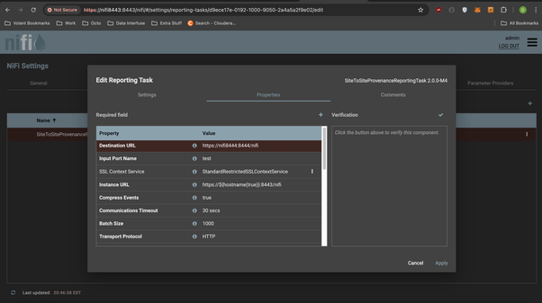

On source NiFi, here's what my SiteToSiteProvenanceReportingTask looks like.

I realized that the reporting task on NiFi8443 is essentially acting like an client and NiFi8444 is acting as the server. I added the NiFi8444 server certificate into a truststore.p12 file on NiFi8443 and created the corresponding SSLContextService to point to that Truststore file.

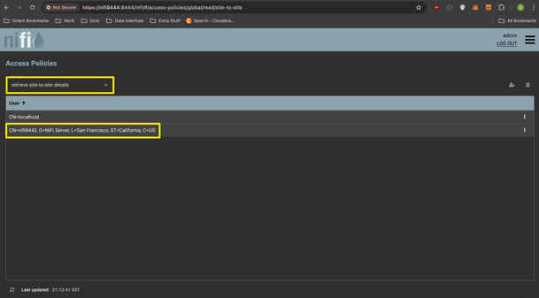

Then I added that identity to two policies. The first one is retrieve-site-to-site -

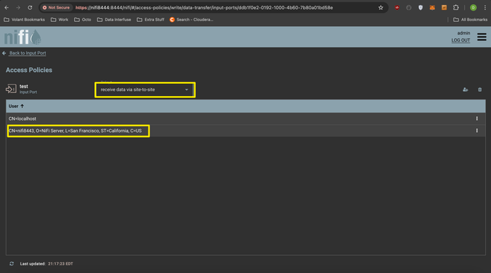

And the second one is the input port -

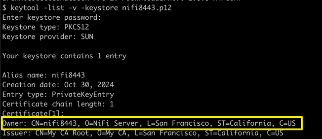

It seems like it has to do with the identity from NiFi8443 not properly being authenticated correctly. But when I run keytool -list -v -keystore nifi8443.p12 on the server certificate I get this -
@MattWho @SAMSAL - Do you know why I getting a 401 unauthorized error?

While you added the public cert for your NiFi8444 to the truststore used in the nifi8443 StandardRestrictedSSLContetService, did you do the same in reverse?
Does your StandardRestrictedSSLContetService also include the keystore?  The Keystore contains the PrivateKey that is used in the mutual TLS exchange with NiFi8444.
