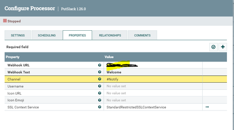

Getting below error while calling Slack channel from Nifi. Used putSlack Processor.
"o.apache.nifi.processors.slack.PutSlack : Failed to open connection

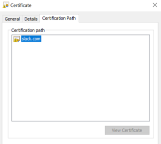

javax.net.ssl.SSLHandshakeException: PKIX path building failed: sun.security.provider.certpath.SunCertPathBuilderException: unable to find valid certification path to requested target "
I have added slack cert in to my truststore.
I am trying to get it tested in local (haven't deployed in to environment server). Added the channel name and webhookURL  (which generated under "companyName.slack.com")
Is there anything i need to add it in local truststore to work?.

The putSlack processor utilizes the StandardRestrictedSSLContextService to define keystore and truststore files the putSlack processor will use.  The truststore must contain the complete trustchain for the target slack server's serverAuth certificate.
