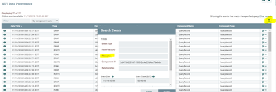

Starting from NiFi-1.8.0 we are going to have filename same as flowfileuuid so you are able to search based on flowfileuuid to find out the specific filename.
If you are using prior to NiFi-1.8 then you can search based on filename using below process instead of clicking on "i"
Click on the right search then you are able to view search events box then keep your desired filename overthere then click on search to get only the specific file from the provenance.

Thanks for Your answer! Using NiFi 1.6.0 --- must have been blind - indeed I haven't seen this search option, sorry. Bye!
