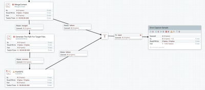

I would appreciate if you guys can point me to where I can find best practices for error handling in NiFi. Below is how I'm envisioning handling errors in my workflows. Would you suggest any enhancements or better ways to do it.
My error handling requirements are simple, basically to log the errored flow files to the file system and send an alert; so all the processors in the dataflow that have a "failure" relationship would send the failed flowfiles to a funnel and from there they would go to an error handling Process group, which does the logging and alerting.

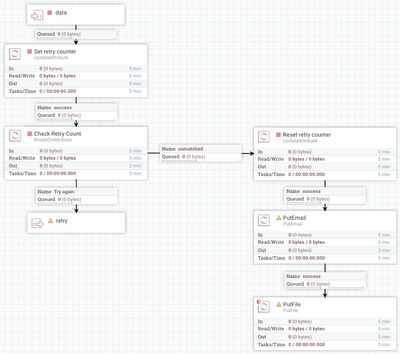

So here you see Failed FlowFiles enter at "data", they are then checked for a failure counter and if one does not exist it is created and set to 1. If it exists, it is incremented by 1. The check recount count will continue to pass the file to "retry" until the same file has been seen x number of times. "Retry" would be routed back to the source processor of the failure. after x attempts the counter is reset, an email is sent, and the file is place in some local error directory for manual intervention.

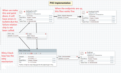

Hello Everyone,
I am following the above suggested failure mechanism by @Matt in my NIFI Project template. But the failure flow is not trigerring the retry mechanism from invokeHTTP Processor. Can anyone let me know what I am missing? Or if this is not the right way, can you please suggest any alternative. Attached the template for the same.40810-nifiissue.png
Thanks
nifi-webapi-integration.xml
Master Mentor
@Dhamotharan P
I highly recommend staring a new HCC question for your particular use case so it gets better visibility. You van always reference this HCC in your new question.
The bulletin and any stack trace from the nifi-app.log when you take your end-point down would also be very helpful. Perhaps it is doing a session rollback instead which leaves the file on the inbound connection rather the routing to failure.
