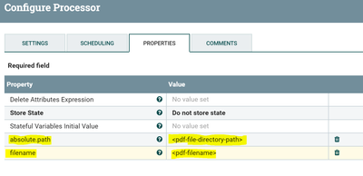

If the PDF file path don't change then you can use UpdateAttribute processor after EvaluateJsonPath
add new properties in update attribute processor.
Then use Fetch File processor
to fetch pdf file for every receipt then use PutEmail processor to send the attached pdf file and include all the attributes.

--other processors--1.EvaluateJsonPath Processor //extract values as attributes2.UpdateAttribute Processor //add directory,filename attributes to the flowfiles3.FetchFile Processor //to fetch the PDF file now we are overwriting the contents of flowfile,attributes will be same there4.PutEmail
By using this way we are fetching the pdf file for every email receipt.
Flow:

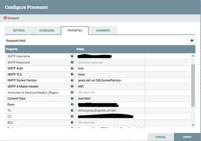

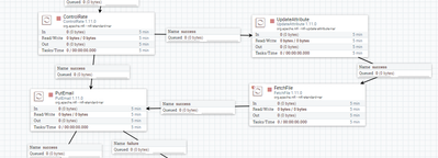

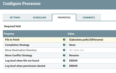

@Shu_ashu  How to configure the flow if  EvaluateJsonPath Processor flow have recipient mail id and FetchFile has the file path. I have configured as below but two mails are getting triggered. Could you help to modify the flow so that only one mail with attachment will trigger ?
