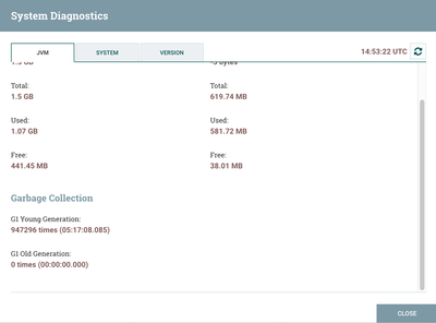

The most common reason for not seeing Heartbeats generated on the configured interval is when you have a lot of java full garbage collection (GC) going on. Garbage collection is a stop the world event. The JVM will do nothing else until the garbage collection has completed. Partial garbage collection is normal and healthy and stop the world events here should be extremely short in duration.
You can look at the GC stats fro your NIFi cluster via the system diagnostics UI. You can get tho this UI via link in the lower right corner of the NiFi summary UI:
Young is normal to see, but you want to see hopefully 0 Old Gen events.
If GC is your issue, you will want to figure out what has changed. New data types or volumes, new dataflows, etc...

I tried exactly what you suggested while I was waiting for your reply. I was able to access the UI without the data flow running. I looked at the System Diagnostics you mentioned earlier. It was "4 times" without data flow running and still "8 times" now after I started data flows.
