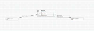

Hi all,
I have been seeing this problem increasingly now that the data gets stuck in between two different processors -- the data being as small as few KBs
what could be the cause of it? The ExecuteSQL contains an SQL insert script.
Moreover, this behavior is random -- occurs randomly on any processor. Does my machine specs count in this? I see my CPU usage and memory are not choking as well.
Any comments on this will be appreciated. Thanks

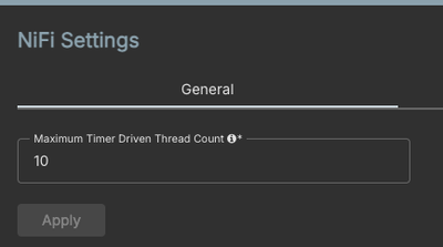

How large is your Max Timer Driven Thread pool set to?
I don't know how many components you have on yoru canvas or how many concurrent tasks you have set on your processors, but if the pool is very small and your CPU load average is not high, you could increase the pool size to see if that helps.  This helps if you have a lot of processors trying to share the tread pool or you have some processors with long running threads holding up threads from the pool.
From the shared screenshot we can see your ExecuteSQL processor has not executed in the previous 5 minutes.

Yes, Max Timer Driven Thread pool is set to 10 by default. At one time, around 10+ processors run in a single proccess group.

If your CPU load average is low relative to the number of cores you have on your Server running NiFi, you could increase the Max timer thread pool.  A typical starting point is 2 to 4 times the number of cores.
