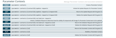

I noticed that in NiFi rest api documentation for version 1.9.0 the parameter context endpoints have been removed, even though they existed in version 1.15.2

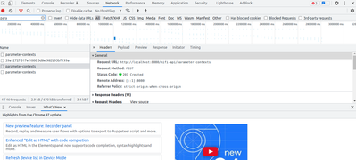

Furthermore, I am using NiFi version 1.13.2 and I can see that in my browser's debugging tools, in the network tab, whenever I create a parameter context, a post request is sent to
and the following payload is being sent :
    "component": {
        "name": "aaaaaaaaaaa",
        "description": "aaaaaaaaaaaaaaaa",
        "parameters": []
    "revision": {
        "clientId": "3d3697c2-017e-1000-0610-31b28073cf9b",
        "version": 0
The parameter context is successfully created. However when I attempt to send a post request from an external API or even hit the previously mentioned endpoint through the browser using the same payload, I get:
