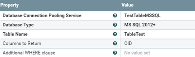

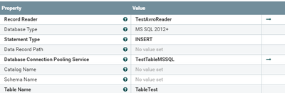

QueryDatabaseTable (reading UniqueIdentifier Column) >> PutDatabaseRecord (writing in the same table and column)
Table:
CREATE TABLE TableTest(
OID [uniqueidentifier] NULL,
Bit1 [bit] NULL
QueryDatabaseTable:
PutDatabaseRecord:
Error:
The conversion from UNKNOWN to CHAR is unsupported.
Supposedly, Nifi's internal array is inverting the columns, putting the bit column in place of the UniqueIdentifier column, producing this "Unknown to char" error. Bug.
