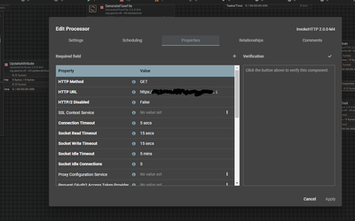

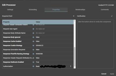

Can you elaborate more on the issue. For example are you getting an error? what is the status code of the response?I assume you are using InvokeHttp processor,   Can you paste screenshot of the  configuration you have ? What kind of API is it and are you sure this a GET API vs Others ? Have you tried to do the GET from pastman or curl ? was it successful?

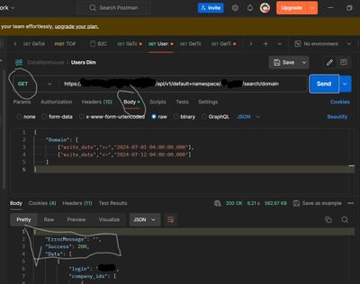

Kindly note that I am using a GET request inside the InvokeHTTP processor. As mentioned above, in order to retrieve the desired data, I need to send a body with the GET request. However, it's working inside Postman.
When it comes to nifi apache 2.0.0 when i run the invokehttp processor(Get) queues remains empty with no errors since no body is sent with request.
while it works for other Get requests that need no body.
