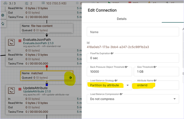

I don't have detailed logs for the last occurrence, but I'll share them if we encounter the issue again. One thing is certain: the node was disconnected due to a discrepancy in the flow.json file. This happened during the deployment of NiFi flows, specifically while upgrading the version of an existing flow.
If it had been a standalone execution of the disconnected node, there wouldn't have been an issue, I believe. The actual problem arose because some flow files were stuck in one of the flows, at a connection where load balancing is enabled with the "partition by attribute" strategy (as shown in the image). I assume those records were waiting to be transferred to the other two nodes, which were not accessible to the disconnected node.
Could you explain this situation further for my better understanding? That will help us take the right steps. Please let me know if more details are required.
Master Mentor
@shiva239
There are numerous things happening when a node is disconnected.
  1. A disconnected node is different then a dropped node.  A cluster node must be disconnected before it can be dropped.
  2. A node can become disconnected in two ways:
    1. Manually disconnected - User manually disconnects a node via the NiFi Cluster UI.  A manually disconnected node will not attempt to auto-rejoin cluster. A user can manually reconnect the node from another node in the cluster via the same Cluster UI.
    2. A node becomes disconnected due to some issue.
A node that is disconnected is still part of the cluster until it is dropped.  Once dropped the cluster no longer considers it part of the cluster.  This distinction matter when it comes to load balanced connections that use a load balance strategy other then Round Robin.
  • Load balance connections use NiFi Site-To-Site protocol to move FlowFiles between nodes.  Only Connected nodes are eligible to have FlowFiles sent over Site-To-Site.
  • Even a disconnected node is still able to load-balance FlowFiles to other nodes still connected in the cluster.   (so when you had 1 node disconnect from cluster, if you went to that nodes UI directly the load balanced connection would appear to processing all FlowFiles normally.  This is because the two nodes where it sends some FlowFiles by attribute are still connected and thus it is allowed to send to them.  The other FlowFiles by attribute destined for disconnected node never leave the node and get processed locally.  Over on the still cluster connected nodes the story is different.  They can only send to connected nodes and any FlowFiles destined for that disconnected node will begin to queue.  Even if you stopped the dataflows on the disconnected node the FlowFiles would continue to queue for that node.  So stopping the dataflow on a node that disconnects would still present same issue.
  • A disconnected node is still aware of what node are part of the cluster and can still communicate with ZK to know which node is the elected cluster coordinator.  Lets say a second node disconnects.  The disconnected node would stop attempting to send to that now disconnected node and queue FlowFiles destined for that node.
  • Only the round robin strategy will attempt to redistribute FlowFile to remaining connected nodes when a node becomes disconnected.  The Partition by attribute and Single Node strategies are used when it is important that "like" FlowFiles end up on the same node for downstream processing (So once a like FlowFile, which in your case are FlowFiles with same value in the orderid FlowFile attribute, is marked for node 3, all FlowFiles with that same orderId will queue for node 3 as long as node three is still a member of the cluster.  A disconnected node is still part of the cluster and will have some "like" FlowFiles already on it, so we would not want NiFi to start sending "Like" data to some other node all of a sudden.  Now if manual user action was taken to drop the disconnected node, then the load-balanced connections would start using a different node for the FlowFiles original being allocated to the disconnected node.
NiFi also offers an off-loading feature. This allows a user with proper authorization to off-load a disconnected node (IMPORTANT: only a reachable and running node can be offloaded successfully. Attempting Offloading of a down or unreachable node will not work).  Once a node is disconnected a user can choose to offload the node this is typical if say a user want to decommission a node in the cluster.  Initiating off-load will send a request to that disconnected node to stop, terminate all running components and then off load the queued FlowFiles to other nodes connected to the cluster.   If cluster nodes where allowed to continue to load-balance to disconnected node(s), this capability would fail as you would end-up with a constant loop of FlowFiles back to disconnected node.  Once offloading completes that disconnected node could be dropped and the FlowFiles that were offload would get load balanced to remaining nodes still members of the cluster.
I think I covered all the basic behind the scenes functionality of load-balanced connection with regards to disconnected node behaviors.
In your scenario, your node, the node became disconnected due to some issue when changing the version of a version controlled process group.  I would recommend a new community question if you need help with that issue as it has no direct relationship with how load-balance connection function or disconnected nodes still running discussed here.
