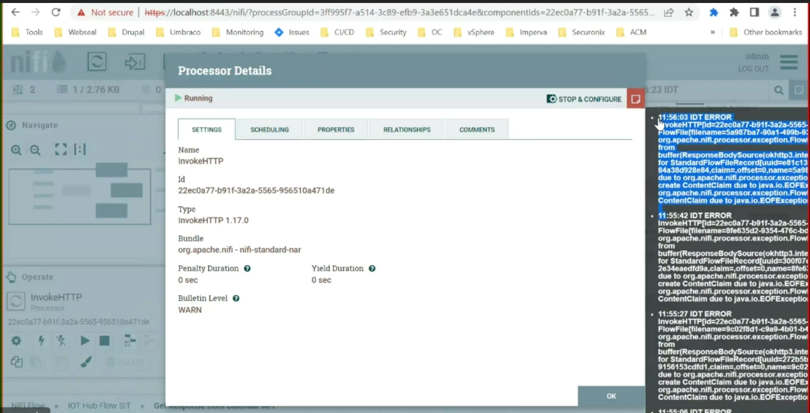

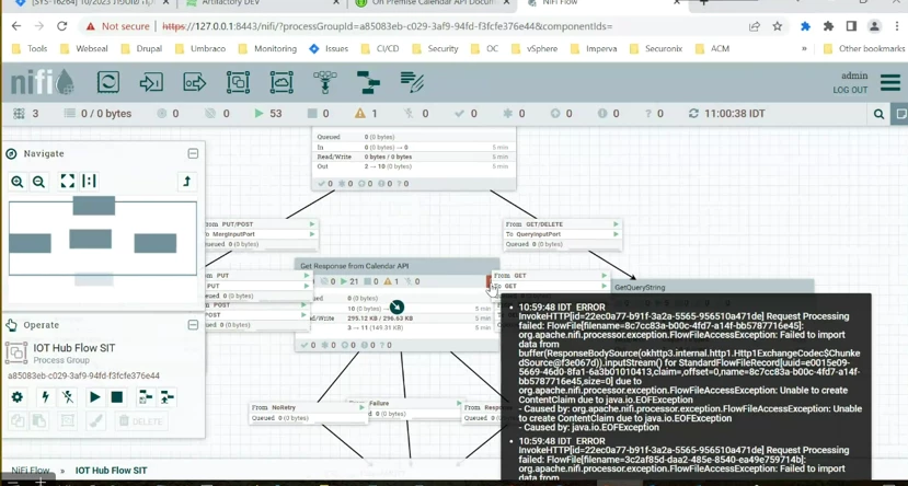

I have attached screenshots of the error if this can help. I am getting this error in invoke http processor where i am sending any api request though request successful getting following error message as - Processing failed : flow file [filename :xxx] : failed to import data from buffer (responsebodysource ()).due to org.apache.nifi.processor.exception.flowfileexception : unable to create contentclaim due to java.io.EOFException
