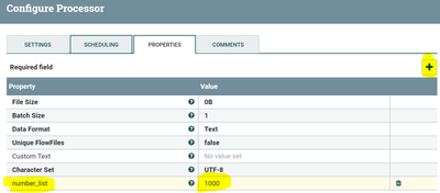

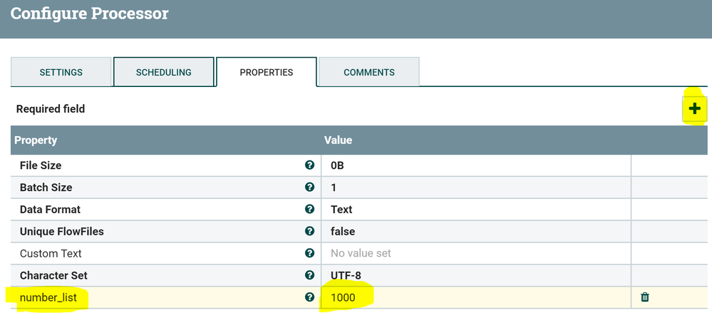

You can evaluate the expression language by using Generate flowfile processor
Configs:-
  1. Drag and drop generate flowfile processor
  2. Right click and click on Configure
  3. In properties tab click on + sign that is highlighted in above screenshot and add new property as
number_list
1000
4.Click on Scheduling Tab and keep Timerdriven with Run schedule as 11111111110 (or) some big number, so the processor trigger 1 flowfile after those many sec that we have given in Run Schedule value.

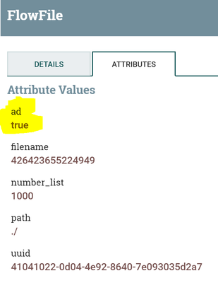

UpdateAttribute Configs:-
Follow same steps as above and add new property as
ad(your property name)
${anyDelineatedValue("${number_list}",","):startsWith("1")}
After update attribute processor we are going to add ad attribute to the flowfile as result of expression that we mentioned i.e
Output:-
In above screenshot we are having ad attribute having value as true.

1 REPLY 1
Master Guru
@Richard Scott
Yes it returns True as attribute value.
${anyDelineatedValue("${number_list}, ","):startsWith("1")} //split the numbers_list string with ,(based on delimiter) and check any of the number_list values is starting with 1 (or) not.
As we are having just 1000 so number_list string then the expression language check for is the number_list any value is starting with 1 so the result is True.
Example:-
For ${anyDelineatedValue("${number_list}, ","):startsWith("1")}
Case1:-
number_list 1000,2000,3000
result True //because our expression language is checking for any of the delineated values and we are having 1000 which is starting with 1 so returns as True.
Case2:-
number_list 2000,2000,3000
result False //because any of the number list values are not starting with 1 so the result is False.
In Addition
Configs:-
number_list
1000
Output:-
