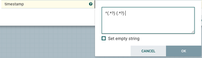

The NiFi expression language was written specifically for working with NiFi attributes. You would first need to use ExtractText processor to get the bits from your content moved into NiFi FlowFile Attributes:
Add a new property to your ExtractText procesor configured as follows:
Note that my Regex above has a white space at the end.

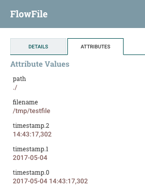

This regex will result in multiple new FlowFile Attributes being created for you:
So no need to followup with any substring NiFi expression language manipulation commands.

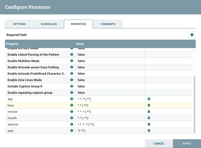

I will still need to do a followup of substring Nifi expression Language because I need the month, day, year, hour, etc saved into different attributes to be able to correctly form my file's filenames and the directory in HDFS.
Master Mentor
@Eric Lloyd
You can still use ExtractText to get all the bits broken out at once by adding multiple new properties:
