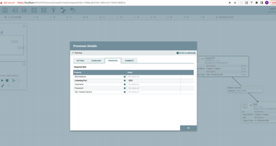

 ListenFTP processor is opened on port 2221

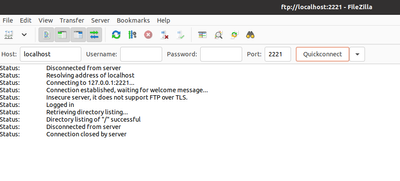

When I say the connection works fine in localhost, I mean that my Nfii service is launched via docker-compose on my computer. When I access Nifi via https://localhost:8443/nifi/ and use a ListenFTP processor on port 2221, the connection via FileZila works. i can transfer files and treat them in Nifi.
Localhost :
FileZila connection :
