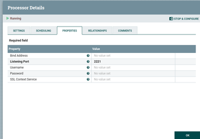

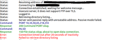

I have a ListenFTP processor opened on a port and when i am trying to connect to it via FileZila i have an error "Failed to retrieve directory listing".
The connection seems to be establish first but then this error occurs.

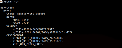

 Nifi is hosted on an ubuntu server running in a docker image
 ListenFTP processor is opened on port 2221
I tried to change some configuration in FileZila but nothing worked.
The connection works well on localhost.

When I say the connection works fine in localhost, I mean that my Nfii service is launched via docker-compose on my computer. When I access Nifi via https://localhost:8443/nifi/ and use a ListenFTP processor on port 2221, the connection via FileZila works. i can transfer files and treat them in Nifi.
Localhost :
FileZila connection :
