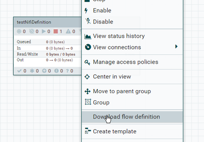

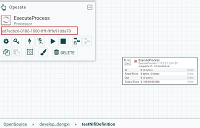

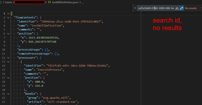

I download Nifi flow definition on a Process Group. Then I search the real id of a processor and get nothing. Why the definition does not keep everything as same as those in a Nifi flow?
I need to compare two Nifi flows in two environment, DEV and UAT. But the definition does not keep all processors' identifier. It is so difficult for me to find differences.

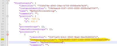

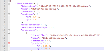

If I may intervene here for a second, I would say that I totally agree with what @MattWho said but in the same time, I think that what you, @wffger2, are trying to achieve might be partially possible.You would still need everything what Matt said, but if you just want to double check and confirm your IDs within your definition flow with the ones from your canvas, you might achieve this goal.
So i tested with two versions right now: 1.15.3 and 1.19.1.
Now, as you can see in the first screenshot, when I downloaded the flow definition for my process group, I have at line 14 the tag "identifier", which has a different ID as the one from the NiFi Canvas. This was done on NiFi 1.15.3
If I do the same exact thing on NiFi 1.19.1, in the exported definition flow, at line 16 I have a new tag, named instanceIdentifier, which contains the exact ID of the processor, from your NiFi Canvas.
In this case, if you just want to have your ID compared to the one from your NiFi Canvas, an upgrade to a newer version might be your solution. But, pointing this again, if you want the connection between the environment, you require everything what Matt just told you.

I just tested on my local machine and if I download the NiFi Flow definition for a Processor Group, I can find each processor ID in that Processor Group. Are you sure you are not looking in a different export from a different environment?
If the same exact flow is imported on a different environment (meaning other servers) and you download the Flow definition, you will not have the same IDs.
For example, in your Process Group on Dev you have an Processor PutFile which has the id 1d29eb87-d66f-31ba-d653-93b704036191. If you exported everything on the UAT Environment that Processor Group and the Processor will not have the same exact IDs as on DEV because NiFi generates new UUIDs for those elements --> maybe the ID 1d29eb87-d66f-31ba-d653-93b704036191 is already in use on the UAT environment by another processor.

The InstanceIdentifier was introduced when NiFi switched from using the flow.xml.gz to the flow.josn.gz for flow persistence.  It is also currently being written to the flows stored in the NiFi-Registry.  I say "currently" because this jira exist and is still open:
https://issues.apache.org/jira/browse/NIFI-11321
So as @cotopaul points out, the "instanceIdentifier" will be unique for each instantiation of the flow definition, but the "identifier" will be the same.  Downside here is every time you want to do a comparison, you'll need to download latest flow definition from DEV and UAT environments and compare for difference based on the Identifiers.
