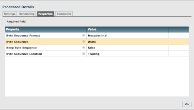

I am able to address this using the SplitContent processor. Check the config. below.
It will split out two files one with Actual content you needed and second is the empty one. You can use update attribute processor to rename the files as per your requiremetns.
