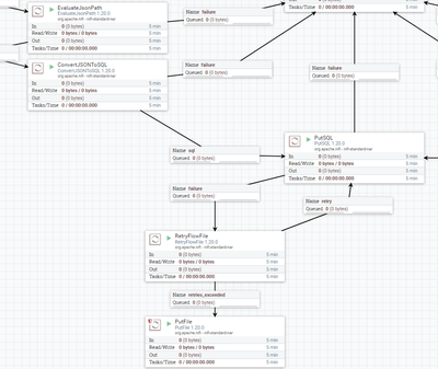

This is the part of our flow concerning

It seems like you are generating your SQL from JSONToSQL kind of processor and then using PUT SQL to execute the generated SQL statement from earlier processor , is this correct? If that is the case I dont think there is an easy way to capture the actual values in the SQL statement as they are expected to be part of the generated sql flow file attribute in the format of "sql.args.N.value" based on the PUTSQL documentation. The only suggestion I have to overcome such thing is to write your custom code inside ExecuteScript processpr after the "retries-exceeded"  relationship to replace the place holders (?,?,?..) in the flowfile content with sql.args.N.value attribute where the N = place holder Index + 1, so you have to write some logic to extract the place holder , save into variable , split the variable using (,), loop through the array of "?", construct new variable with sql.args.[i+1]ivalue , when the loop finish replace the place holder string with the new value string , then store new result into new flowfile content and send to success. For more info on writing custom script using ExecuteScript :

@danielhg1285,
While the solution provided by @SAMSAL seems to be better for you and more production ready, you could also try the below things. This might work if you are using a stable statement all the time and if are not restricted to see the exact INSERT Statement but rather see the values trying to be inserted.
- Shortly after RetryFlowFile, you can add an AttributesToJSON processor and manually define all the columns which you want to insert in the Attributes List Property. Make sure that you use the attribute name from your FlowFile (sql.args.N.value) in your correct order and you set Destination = flowfile-content. In this way, you will generate a JSON File with all the columns and all the values which you have tried to insert but failed.
- After AttributesToJSON, you can keep your PutFile to save your file locally on your machine, hence opening it whenever and wherever you want 🙂
PS: This is maybe not the best solution, due to the following reasons, but it will get you started on your track:
- You will need to know how many columns you have to insert and each time a new column will be added you will have to modify your AttributesToJSON processor.
- You will not get the exact SQL INSERT/UPDATE Statement, but a JSON File containing the column-value pair, which can easily be analyzed by anybody.
