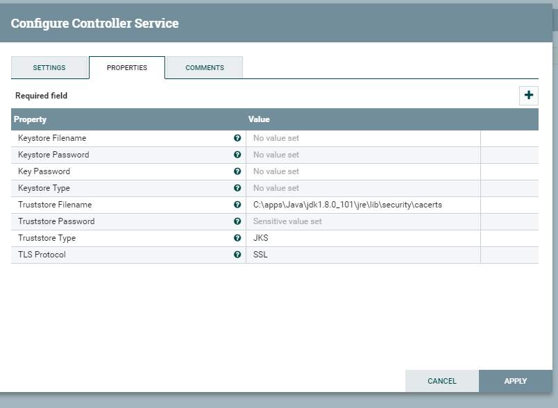

New Contributor
Can you picture your SSLContextService config

New Contributor
Not allowing me to post more than 6000 chars for a reply so I have posted it as an answer at the top level if you want the complete stacktrace.
Attached is more stack trace and screenshot of the processors
2017-12-13 15:31:46,056 ERROR [StandardProcessScheduler Thread-6] o.a.nifi.processors.standard.InvokeHTTP InvokeHTTP[id=4b978fb8-0160-1000-9580-343051a9b895] InvokeHTTP[id=4b978fb8-0160-1000-9580-343051a9b895] failed to invoke @OnScheduled method due to java.lang.RuntimeException: Failed while executing one of processor's OnScheduled task.; processor will not be scheduled to run for 30 seconds: java.lang.RuntimeException: Failed while executing one of processor's OnScheduled task.java.lang.RuntimeException: Failed while executing one of processor's OnScheduled task.	at org.apache.nifi.controller.StandardProcessorNode.invokeTaskAsCancelableFuture(StandardProcessorNode.java:1483)	at org.apache.nifi.controller.StandardProcessorNode.access$000(StandardProcessorNode.java:103)	at org.apache.nifi.controller.StandardProcessorNode$1.run(StandardProcessorNode.java:1302)	at java.util.concurrent.Executors$RunnableAdapter.call(Executors.java:511)	at java.util.concurrent.FutureTask.run(FutureTask.java:266)	at java.util.concurrent.ScheduledThreadPoolExecutor$ScheduledFutureTask.access$201(ScheduledThreadPoolExecutor.java:180)	at java.util.concurrent.ScheduledThreadPoolExecutor$ScheduledFutureTask.run(ScheduledThreadPoolExecutor.java:293)	at java.util.concurrent.ThreadPoolExecutor.runWorker(ThreadPoolExecutor.java:1142)	at java.util.concurrent.ThreadPoolExecutor$Worker.run(ThreadPoolExecutor.java:617)	at java.lang.Thread.run(Thread.java:745)Caused by: java.util.concurrent.ExecutionException: java.lang.reflect.InvocationTargetException	at java.util.concurrent.FutureTask.report(FutureTask.java:122)	at java.util.concurrent.FutureTask.get(FutureTask.java:206)	at org.apache.nifi.controller.StandardProcessorNode.invokeTaskAsCancelableFuture(StandardProcessorNode.java:1466)	... 9 common frames omittedCaused by: java.lang.reflect.InvocationTargetException: null	at sun.reflect.NativeMethodAccessorImpl.invoke0(Native Method)	at sun.reflect.NativeMethodAccessorImpl.invoke(NativeMethodAccessorImpl.java:62)	at sun.reflect.DelegatingMethodAccessorImpl.invoke(DelegatingMethodAccessorImpl.java:43)	at java.lang.reflect.Method.invoke(Method.java:498)	at org.apache.nifi.util.ReflectionUtils.invokeMethodsWithAnnotations(ReflectionUtils.java:137)	at org.apache.nifi.util.ReflectionUtils.invokeMethodsWithAnnotations(ReflectionUtils.java:125)	at org.apache.nifi.util.ReflectionUtils.invokeMethodsWithAnnotations(ReflectionUtils.java:70)	at org.apache.nifi.util.ReflectionUtils.invokeMethodsWithAnnotation(ReflectionUtils.java:47)	at org.apache.nifi.controller.StandardProcessorNode$1$1.call(StandardProcessorNode.java:1306)	at org.apache.nifi.controller.StandardProcessorNode$1$1.call(StandardProcessorNode.java:1302)	... 6 common frames omittedCaused by: java.lang.NullPointerException: null	at java.security.Provider$ServiceKey.<init>(Provider.java:872)	at java.security.Provider$ServiceKey.<init>(Provider.java:865)	at java.security.Provider.getService(Provider.java:1039)	at sun.security.jca.ProviderList.getService(ProviderList.java:332)	at sun.security.jca.GetInstance.getInstance(GetInstance.java:157)	at java.security.Security.getImpl(Security.java:695)	at java.security.KeyStore.getInstance(KeyStore.java:848)	at org.apache.nifi.processors.standard.InvokeHTTP.setSslSocketFactory(InvokeHTTP.java:571)	at org.apache.nifi.processors.standard.InvokeHTTP.setUpClient(InvokeHTTP.java:540)	... 16 common frames omitted
New Contributor
Attached more stack trace and screenshot of the processors

Did you ever resolve this? I have the same issue. InvokeHTTP only when using HTTPS.
This might not be a resolution but the error went away under the following circumstances for me:
  • Use HTTPS
  • Do not set an SSL Context Service
  • Make sure your SSL endpoint has the full chain of trust.
