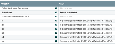

AFAIK, Jolt doesn't have functions for doing transformations of a single value (such as split, extract, etc.). If the "params" field will always contain the same parameters in the same order (at least sn being first, c being second, and 4 p's) then you can extract "params" into an attribute using EvaluateJsonPath (with a JSONPath of $.params), then an update attribute with something like this:
If the parameters are arbitrary (such as number of p's, or can be in any order), you might be better off with ExecuteScript for your custom logic. Here's a Groovy script you can use in ExecuteScript to do what you describe above:
