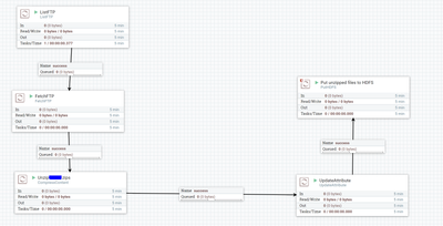

Trying to get files from an FTP server with ListFTP/FetchFTP, but these speicifc processors are so confusing to me.
I have scheduled ListFTP to fire also with Cron and time-driven every 10 secs or so, but even though it shows a task is executed in the ListFTP processor, no flowfiles come out of it! GetFTP works fine, but i wanna implement it with List/Fetch to get only the new files in the dir.
Initially i scheduled the flow with cron at 03:00 last night when i knew a new file would become available in the FTP server around 1. However this morning i saw that nothing was transfered to HDFS. So i changed scheduling to every 60 secs to test it right away and guess what, i got the new file! So i thought Cron is the problem, deleted the test-file from HDFS and scheduled the flow to run at 10:00 this morning, as expected a task was created but no flowfiles were passed to FetchFTP.
Switching back to timer-driven scheduling to get the file i deleted back to HDFS from the FTP server, but this time there are no flowfiles created even for this scheduling option. What is going on here guys?

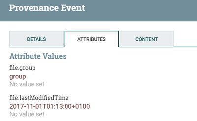

Hi @Abdelkrim Hadjidj thanks for the reply. My Nifi version is 1.1.0 so what you say makes sense.
My flows are not so time-sensitive, meaning i can delay the ingestion for a couple of hours, but i want to understand a bit better the operations:
This is the timestamp in the FTP server of the last file transfered by this Nifi flow (via Data Provenance)
Now, if i schedule the LisFTP processor to fire e.g. today at 15:00 i would expect that the file would be parsed with no problem. This bug means that the file would be never parsed as long as it is the last modified file in this location? So in other words, ListFTP/HDFS/whatever performs a listing only if it sees that there are files with most recent timestamp than the last transfered in the directory? Also you mention to scheule cron for 3 & a bit later, is there an option to have 2 scheduling plans for one processor?
As far as i know, with cron you can only say something like: run this every 5 mins of that hour or so. Thanks in advance!
