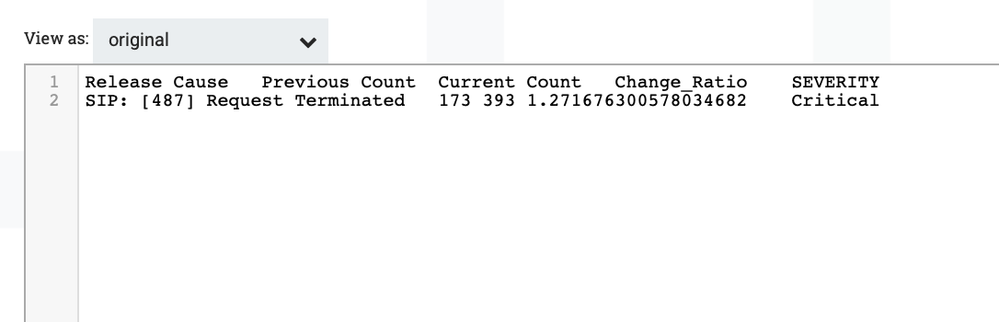

I understand you are not able to figure out the exact ReplaceText syntax that you need.  I have quickly created a flow and validated the following works as demonstrated.  I had to use \t to match your string:
Output:
The regex you need is:
${'$1':replace(',','\t')}
Table formatting is something entirely different and is not part of "csv" parsing....
