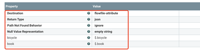

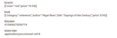

As you mentioned, the output flow file you want get should be with two attributes.
Here you can try following:
1. Use EvaluateJsonPath processor, add two properties and configure it using JSONPath like below:
Details on JSONPath, you may refer to https://github.com/json-path/JsonPath
