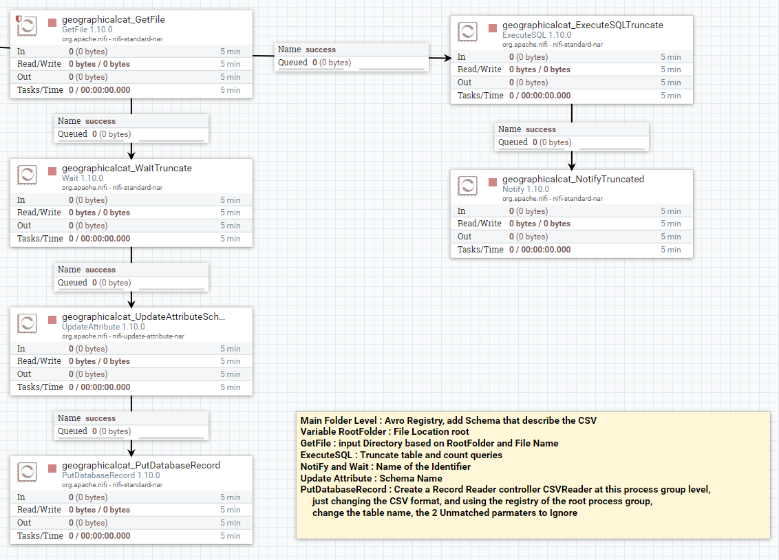

New Contributor
Hi,
I'm trying to execute the SQL command "Truncate Table". All the post I've seen recommand like here using PutSQL for that.
I've the error message :
ERROR
PutSQL[id=a154204d-016e-1000-d9c9-d0d79519e70e] Failed to update database for
[StandardFlowFileRecord[uuid=6c92c3bc-a219-4017-9641-dc4d21ab061a,claim=StandardContentClaim [resourceClaim=StandardResourceClaim[id=1574662524581-1, container=default, section=1], offset=3900, length=35],offset=0,name=6c92c3bc-a219-4017-9641-dc4d21ab061a,size=35]]
due to Query must be like 'INSERT INTO [db.]table [(c1, c2, c3)] VALUES (?, ?, ?)'.
Got: truncate table SBST.geographicalcat;
routing to failure: java.sql.SQLSyntaxErrorException: Query must be like 'INSERT INTO [db.]table [(c1, c2, c3)] VALUES (?, ?, ?)'.
I use all default parameters from NiFi 1.10 processor.
I've try with the truncate query as constant in the SQL Statement parameter or this one empty and the SQL comming from the incoming flow file.
The database is Clickhouse, using last JDBC.
The truncate command work when in the Pre-SQL of the ExecuteSQL processor.
So NiFi and the JDBC should be able to run it.
The NiFi doc explain that PutSQL is only for INSERT or UPDATE.
It look like PutSQL is not allowing anything else than Insert / Update, or is there a parameter that I should change ?
Any other solution ? (I can't use ExecuteSQL as I don't want to query anything, just truncate before insert)
thanks
New Contributor
Hi, for the moment I've done it with two branches and a Notify/Wait.
From the GetFile, a first Success branch go to the Execute SQL that have a Pre-Query that do the Truncate, and a Query that do a simple select query (here a select count() of the truncated table that should return 0 and could be used as check), then that go to a Notify to inform that the truncate is done.
From the GetFile, a Second Success branch go to the Wait (for the truncate to be done), than move to the PutDatabaseRecord (with a UpdateAttibute before to set the schema.name).
Also here
https://stackoverflow.com/questions/59026724/nifi-1-10-putsql-error-query-must-be-like-insert/590692...

            <label>Main Folder Level : Avro Registry, add Schema that describe the CSV
Variable RootFolder : File Location root
GetFile : input Directory based on RootFolder and File Name
ExecuteSQL : Truncate table and count queries
NotiFy and Wait : Name of the Identifier
Update Attribute : Schema Name
PutDatabaseRecord : Create a Record Reader controller CSVReader at this process group level,
     just changing the CSV format, and using the registry of the root process group,
     change the table name, the 2 Unmatched parmaters to Ignore</label>

                    <entry>
                        <key>Database Connection Pooling Service</key>
                        <value>
                            <identifiesControllerService>org.apache.nifi.dbcp.DBCPService</identifiesControllerService>
                            <name>Database Connection Pooling Service</name>
                        </value>
                    </entry>
                    <entry>
                        <key>sql-pre-query</key>
                        <value>
                            <name>sql-pre-query</name>
                        </value>
                    </entry>
                    <entry>
                        <key>SQL select query</key>
                        <value>
                            <name>SQL select query</name>
                        </value>
                    </entry>
                    <entry>
                        <key>sql-post-query</key>
                        <value>
                            <name>sql-post-query</name>
                        </value>
                    </entry>
                    <entry>
                        <key>Max Wait Time</key>
                        <value>
                            <name>Max Wait Time</name>
                        </value>
                    </entry>
                    <entry>
                        <key>dbf-normalize</key>
                        <value>
                            <name>dbf-normalize</name>
                        </value>
                    </entry>
                    <entry>
                        <key>dbf-user-logical-types</key>
                        <value>
                            <name>dbf-user-logical-types</name>
                        </value>
                    </entry>
                    <entry>
                        <key>compression-format</key>
                        <value>
                            <name>compression-format</name>
                        </value>
                    </entry>
                    <entry>
                        <key>dbf-default-precision</key>
                        <value>
                            <name>dbf-default-precision</name>
                        </value>
                    </entry>
                    <entry>
                        <key>dbf-default-scale</key>
                        <value>
                            <name>dbf-default-scale</name>
                        </value>
                    </entry>
                    <entry>
                        <key>esql-max-rows</key>
                        <value>
                            <name>esql-max-rows</name>
                        </value>
                    </entry>
                    <entry>
                        <key>esql-output-batch-size</key>
                        <value>
                            <name>esql-output-batch-size</name>
                        </value>
                    </entry>
                </descriptors>
                <executionNode>ALL</executionNode>
                <lossTolerant>false</lossTolerant>
                <penaltyDuration>30 sec</penaltyDuration>
                <properties>
                    <entry>
                        <value>517808ef-0266-3e67-0000-000000000000</value>
                    </entry>
                    <entry>
                        <value>truncate table SBST.geographicalcat</value>
                    </entry>
                    <entry>
                        <value>select count(*) as cnt from SBST.geographicalcat</value>
                    </entry>
                    <entry>
                    </entry>
                    <entry>
                        <value>0 seconds</value>
                    </entry>
                    <entry>
                        <value>false</value>
                    </entry>
                    <entry>
                    </entry>
                    <entry>
                        <value>NONE</value>
                    </entry>
                    <entry>
                        <value>10</value>
                    </entry>
                    <entry>
                        <value>0</value>
                    </entry>
                    <entry>
                        <value>0</value>
                    </entry>
                    <entry>
                        <value>0</value>
                    </entry>
                </properties>
                <runDurationMillis>0</runDurationMillis>
                <schedulingPeriod>0 sec</schedulingPeriod>
                <schedulingStrategy>TIMER_DRIVEN</schedulingStrategy>
                <yieldDuration>1 sec</yieldDuration>
            </config>
            <executionNodeRestricted>false</executionNodeRestricted>
            <name>geographicalcat_ExecuteSQLTruncate</name>
            <relationships>
                <autoTerminate>true</autoTerminate>
                <name>failure</name>
            </relationships>
            <relationships>
                <autoTerminate>false</autoTerminate>
                <name>success</name>
            </relationships>
            <state>STOPPED</state>
            <style/>
            <type>org.apache.nifi.processors.standard.ExecuteSQL</type>
        </processors>
            <name>geographicalcat_NotifyTruncated</name>
            <relationships>
            </relationships>
            <relationships>
            </relationships>
            <style/>
            <type>org.apache.nifi.processors.standard.Notify</type>
        </processors>

Hi Adil,
Can you provide complete details with configuration for the data flow you implemented?
It will be great help.
Thanks,
Sandip
New Contributor
Please send me the screen shots of the flow. I am working with the same use case  writing csv content to DB. help me I am unable define the properties in the processors.
