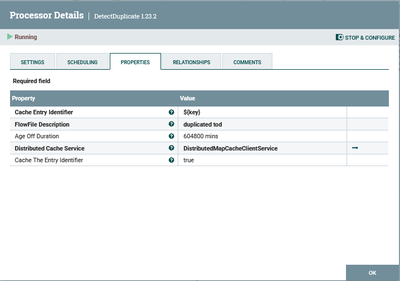

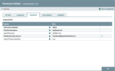

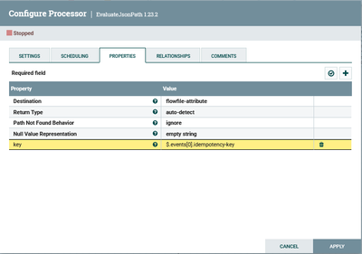

2.transform the content to the key attribute with the
EvaluateJsonPath processor.Then I use the key value in the detectDuplicate processor as I share below.I confirmed that the attribute of the flowfile that cannot be deduplicated is.Could this be related to the flowfile arriving at the same time?

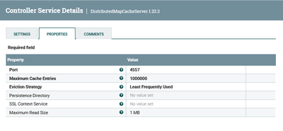

I see that you configured the DetectDuplicate processor with an age off of 420 days; however, DistributedMapCache server has a configured max cache entries with a default of 10,000.  So possibly due to volume cache entries are being removed from the cache server resulting in issues detecting duplicates.  The DistributedMapCache also holds all cache entries in NiFi heap memory and is not a good cache server to use in high volume caches (because of heap usage).  DistributedMapCache also offers no high availability.    This is becomes even more of an issue with a NiFi cluster.  You would be better off using an external map cache server.

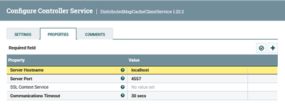

If you are using a NiFi cluster, make sure your DistributedMapCacheClient is configured to connect to one specific DistirbutedMapCacheServer.  I have seen misuse here where individuals configured it to connect to local host or each NiFi node to its own host's map cache server.  The Map cache servers running on each node do not share data.

2.distributedMapCacheClient and DistributedMapCacheServer as I share below;

I configured the DetectDuplicate processor with an age off of 10 days.It doesn't matter if the processor can't deduplicate messages.It's bad for the ConsumeKafka to read the same message twice.

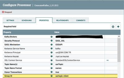

The consumeKafka processor should not be reading the same message twice.  The processor should be maintaining local state (since you are not clustered) in NiFi's local state directory. Make sure that you are not having disk space or permissions issues that may prevent the writing of that local state.  You can write click on the ConsumeKafka processor to view the current stored state.
The consumeKafka processor creates a consumer group using the GroupID configured in the processor, so make sure you do not have multiple consumeKafka processor consuming from the same Kafka Topic using the same Group ID.  For optimal performance the number of concurrent tasks configured on the consumeKafka processor should match the number fo partitions on target topic.
Do you see any Kafka rebalance going on?   Will happen when you have more consumers than partitions in a the consumer group that is consuming from that topic.  A rebalance can affect the commit of the offset resulting in possible data duplication.
