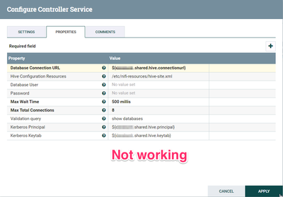

We are trying making our processor using custom properties for environment independent.

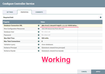

In this case we are using a SelectHiveQL processor which is working if the Database Connection URL is hardcode.
If the Database Connection URL is a reference as done with Kerberos Principal and Kerberos Keytab it return a error, when running SelectHiveQL.
The pictures show the two scenarios.

How is it possible to do a custom property reference in Database Connection URL?

Thx for answer. We are using a older version today. As showed only some of the fields is supported for Expression Language.
HDF Version 2.1.1 - Powered by Apache NiFi - Version 1.1.0.2.1.2.0-10
