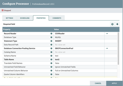

This is my NiFi configuration:

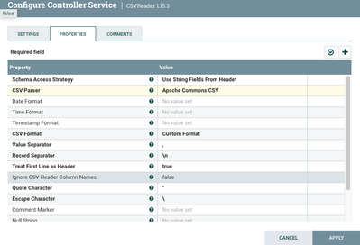

I followed the template from another question I found here and removed some parts that I find like I don't need (or maybe I need??) = removed the  AvroSchemaRegistry and instead used Use String Fields From Header.
I tried many things from exporting values with double quotes,single quotes but still didn't manage to figure out how to load empty/blank/'' values instead of NULLs.

@i_am_dba  This is a very difficult one to explain.  I think the issue is the string schema, or removing the avro schema you mentioned.  My first suggestion would be to try to specific the schema which should help getting the data into the right formats.   An alternate solution is to try and do that manually by replacetext/regex,etc but that is not the ideal solution.   That said, another higher level suggesting is to update the upstream datasource to permanently solve the instability from '' (blank string), 'null' (string), or actual NULL (not a blank, '', or string at all).
