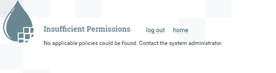

Hi Guys ,i have a problem with Nifi login   please can´t help me ?
this problem start when open the web interface of Nifi later config ldap login  .Present the next message
has been attached imagen .

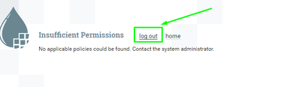

for fix the problem -> select log out
is there any other solution ?

The UI you are seeing is telling you that your ldap user credentials have successfully been authenticated; however, your user identity is not authorized within NiFi to "view the UI".
NiFi Access Policies
The ldap-provider configured in the login-identity-providers.xml handles the authentication process.
The configuration within the authorizers.xml handles the authorizing of those authenticated user identities.
You can tail the nifi-user.log  while you login to see that your user identity that is resulting from your successful authentication.  You will also then see the not authorized log output with the missing access policy.

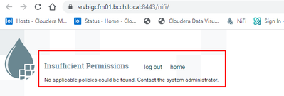

Step 2 show the problem

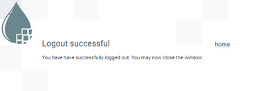

Step 3 Select" log out " option

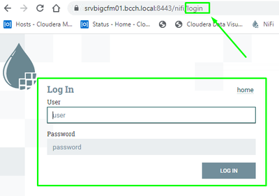

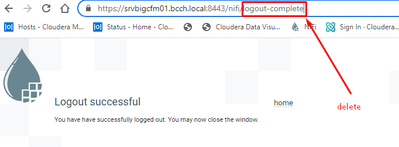

Step 4 : in the Url delete "logout-complete" and add "login"
Do you know why this behavior occurs?

You need to create an initial admin account ,
Go to your authorizers.xml file and add your ldap username "cn=xxx,ou=xx,dc=xxx,dc=xxx" in the Initial Admin Identity property, it will create admin user and you will log on to NiFi as admin and create policies for other users

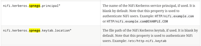

Spnego based authentication is enabled when the following properties have been configured in the nifi.properties file:
Make sure these two properties are clear to disable spnego auth challenge to your browser.
If Spnego auth challenge is not successful, NiFi moves on to next auth method such as a configured login provider like the ldap-provider you have setup.

- Clear the two Spnego properties if configured in the nifi.properties file. (if already blank, then we know a TLS certificate is what is being used.
