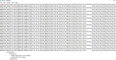

I am able to see some anomalies in the flow.xml.gz file when i unzipped and looking around it , one of the property value inside of it is having almost a million null values , this is must be some kind of bug and resulting in this bytearray outofmemory error , take a look at the below snap
Master Mentor
@Neil_1992
I strongly recommend not setting your NiFi heap to 200GB.
Java reserves the XMS space and grows to the XMX space as space is requested.
Java Garbage Collection (GC) execution to reclaim heap no longer being used does not kick in to ~80% of heap is used. That means GC in your case would kick in at around 160+ GB of used heap.  All GC execution is stop-the-world activity which means your NiFi will stop doing anything until GC completes. This can lead to long pauses resulting node disconnections, issues with timeouts with dataflows to external services ,etc.
When it comes to flow.xml.gz file, you are correct that it is uncompressed and loaded into heap memory.
The flow.xml.gz contains:
  • Everything you add via the NiFi UI to the canvas (processors, RPG, input/output ports, funnels. labels, PGs, controller services, reporting tasks, connections, etc.).  This includes all the configuration of fro each of those components.
  • NiFi Templates are also stored in the flow.xml.gz, uncompressed and loaded in to heap as well.  Once a NiFi template is created, it should be downloaded, stored outside of NiFi, and local copy of template inside of NiFi deleted.
As far as your specific flow.xml.gz, I see a closing tag "</property>" following that indicates that some component has a property which typically consists of a "name" and "value" with the huge null laced null strings in the value field.  I'd scroll up to see which component this property belongs to and then check why this value was set.  Maybe it was a copy paste issue?  Maybe this is just part of some template that was created with this large string for some purpose?  Nothing here says with any certainty that there is a bug.
