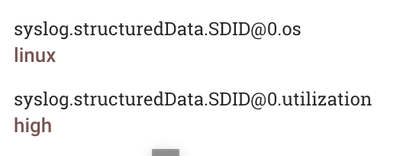

When you use ParseSyslog5424, the attributes in the structured data part of of the syslog message are parsed and added to the flowfiles as attributes. For example, the following syslog message:
<35>1 2013-10-11T22:14:15.003Z client_machine su - - [SDID@0 utilization="high" os="linux"] 'su root' failed for joe on /dev/pts/2
 Will yield a flowfile including the following attributes:

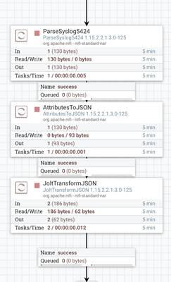

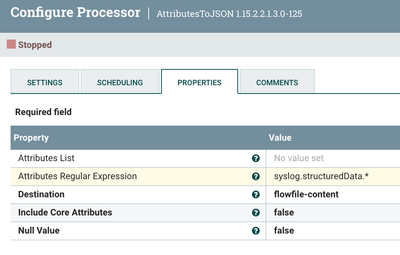

Super Guru
Hi @Griggsy ,
You don't need to use regex for this. You can, for example, connect the output of the ParseSyslog5424 directly to the following AttributesToJson processor:
The output of this will be a JSON like the one below:
  "syslog.structuredData.SDID@0.os" : "linux",
  "syslog.structuredData.SDID@0.utilization" : "high"
You can then use a JoltTransformJSON process to transform the above into your final product. For example, the following JOLT specification:
    "operation": "shift",
    "spec": {
      "syslog.structuredData.*.*": {
        "@": "&(1,2)"
Will produce the following output:
  "os" : "linux",
  "utilization" : "high"
This is the flow:
Cheers,
André
Was your question answered? Please take some time to click on "Accept as Solution" below this post.
