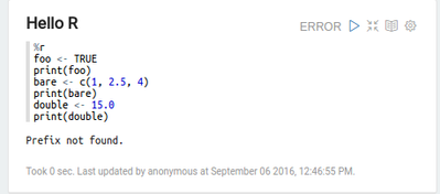

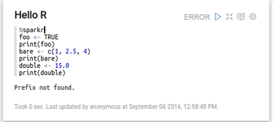

When I view the interpreters tab, the following interpreters appear.
- angular - jdbc - livy - markdown - sh - spark
By using the example notebooks, I can see that the %sh, %md, and %pyspark interpreters work, but no %r interpreter exists.
No %r interpreter.
No %sparkr interpreter.
