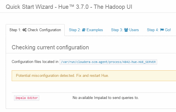

We are running CDH 5.3.3 with Hue 3.7.0, and just added impala via Cloudera Manager. Whenever we log on to Hue, the "No available Impalad to send queries to." appears. Cloudera Manager doesn't report anything wrong with either impala or Hue. The impala and Hue logs don't show any errors.
Any help would be greatly appreciated.
Thanks!
For completeness, I also want to add that the impala-shell works without a problem. The issue seems to be restricted to Hue.

Problem solved. Rebooting the cluster servers didn’t fix the issue. The problem was due to Hue being configured with LDAP. Even though I didn’t find anything that says otherwise, I didn’t think that Having LDAP implemented for Hue required Impala too to be configured for LDAP. After doing that the misconfiguration message disappears, and everything works fine.

I get the message right after I log on to Hue, right at the time Hue checks the configuration. As for the app, if I click on it, the browser hangs for a while before finally showing the Impala editor page. However, no list of databases is shown as the app seems unable to retrieve any.

I'm sorry, bear with me. On the configuration page for Hue, if I click on "desktop" in the "Configuration Sections and Variables" section I don't see check_config. Am I looking in the wrong place?
Highlighted
Re: No available Impalad to send queries to
Contributor
Unless you are talking about the Hue main page. Here is a snapshot that shows what I see after logging on to Hue:
