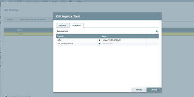

Given this static_IP:<port> in registry client.

What i am saying is that rest-api call response you got via command line is probably not the exact same request made by NiFi.   What that response json tells you is that the user that made the request only has READ to all three buckets. You did not share the complete rest-api call you made, so I am guessing you did not pass any user authentication token or clientAuth certificate in yoru rest-api request and this that request was treated as bing made by an anonymous user.  Since your bucket(s) have the "make publicly visible" checked, anonymous user will have only READ access to the buckets.
In NiFi you are trying to start version control on a Process group.  That means that the NiFi node certificate needs to be authorized on all buckets and authorized to proxy the NiFi authenticated user (who also needs to have read, write on the specific bucket to start version control.  If the response received back to NiFi during the request is that nodes or user on has READ, then no buckets would be shown in that UI since the action that UI is performing would be a WRITE.
You should use the "developer tools" in your web browser to capture the actual full request  being made by NiFi when you try to start version control on a process group.  Most developer tolls even give you and option to "copy as curl" which you can then just paste in a cmd window and execute manually yourself outside of NiFi to see the same response NiFi is getting.
My guess here is that you are having a TLS handshake issue resulting in yoru requests to NiFi-Registry being anonymous requests.   The NiFi logs are not going to show you details on what authorization was on the NiFi-Registry side (you'll need to check the nifi-registry-app.log for that).  All the NiFi log you shared shows is that your "new_admin" was authorized to execute the NiFi rest-api endpoint.  This triggering the connection attempt with NiFi-Registry which also appeared successful (likely as anonymous).
If you look at the verbose output for the NiFi keystore, NiFi truststore, NiFi-Registry keystore, and NiFi-Registry truststore, you'll be able to determine if a mutual TLS exchange would even be possible between the two services using the keystore and truststores you have in place.  These versbose outputs which you can get using the keytool command will also show you the EKUs and SANs present on your certificates.
<path to JDK>/keytool -v -list -keystore <keystore or truststore file>
When prompted for password, you can just hit enter without providing password.
The screenshots you shared showing the authorizations configured in NiFi-Registry are sufficient.  I was simply pointing out that you gave too much authorization to your NiFi node in the global policy section.   This is why i am leaning more to a TLS handshake issue resulting in an anonymous user authentication rather then an authorization issue.  You'll also want to inspect your nifi-registry-app.log for the authorization request coming from NiFi to see if is authorizing "anonymous" or some other string.  Perhaps you have some identity mapping pattern configured on NiFi-Registry side that is trimming out the CN  from your certificate DNs?  In that case you could also see this behavior because your NiFi-Registry would be looking up authorization on different identity string (instead of "CN=new_admin, OU=Nifi, i maybe looking for just "new_admin").  NiFi and NiFi-Registry authorizations are exact string matches (case sensitive); otherwise, treated as different users.

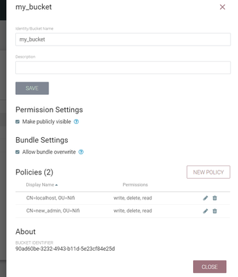

The rest-api output does nit match with your other image's authorizations.  I am going to guess that the rest-api call you made did not include a certificate?  Your bucket image shared shows that the bucket "my_bucket" was created as a "public" bucket meaning that anyone can view that bucket and the flows stored within that bucket (Rest-Api call returned "canRead: true" and canWrite: false", i'd expect both of these to return true if you passed a certificate for localhost or new_admin as your other image shows read, write, and deleted authorized for those users on "my_bucket".
In order to see a bucket in NiFi when starting version control on a process group, The authenticated user in NiFi must be authorized "write" on the bucket.
The permission required are:
1. NiFi node certificate must have "clientAuth and serverAuth extendedKeyUsage" and that clientAuth certificate needs to be authorized for Read,Write, Delete on "Can Manage Bucket" and "Can Proxy User Requests".  NO other authorizations are needed for the NiFi node certificate.
2.  The Authenticated User in NiFi which is being proxied via the NiFi node certificate needs to be authorized for the following on any bucket that users wants to use:
   2a:  READ - ability to import a version controlled flow from the NiFi-Registry bucket.
   2b:  WRITE - ability to start version control or commit new version of a flow to NiFi-Registry
   2c:  DELETE - ability to delete a flow from a bucket via the NiFi-Registry UI.
So I would start by getting a verbose listing of the keystore used in nifi.properties file to make sure that the PrivateKeyEntry has clientAuth as an ExtendedKeyUsage (EKU).
Then I would uncheck the "make publicly visible" box for your "my_bucket" and make your rest-api call again to see what permissions your NiFi node certificate (localhost) and new_admin have.  Remember that what is returned by that call dictates what will show in the various UIs within NiFi.

Thanks @MattWho for taking time to answer this.
I created certificates using tls toolkit like below:
./bin/tls-toolkit.sh standalone -n localhost -C 'CN=admin,OU=NiFi' --subjectAlternativeNames <IP of Docker Registry> -o ./certs
"1. NiFi node certificate must have "clientAuth and serverAuth extendedKeyUsage" and that clientAuth certificate needs to be authorized for Read,Write, Delete on "Can Manage Bucket" and "Can Proxy User Requests".  NO other authorizations are needed for the NiFi node certificate."
Dos it mean, i need to recreate in different way ? or something wrong in above command..?
My rest api call is something i saw in the logs and just typed in browser and it worked and gave me above json as result.
