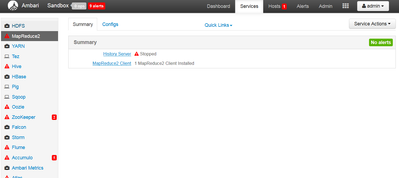

I am using the Hortonworks Sandbox - it previously ran just fine.
I did not use the system for some time and it seems the machine is broken even after a reboot.
Whenever I start a service (e.g. HIVE) all proces steps appear green. For about 60 seconds the service turns up green BUT then switches back to RED. It does not matter which service I start - it's the same behaviour for all services ... all services start up fine BUT then switch to RED.
The 9 alerts are all OLD errors from 5 months ago ... any hint where to look for the error is appreciated.

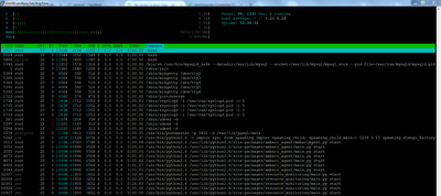

My VM has 16GB of memory. So i should be fine. Also HTOP does not show more memory usage than 6GB (I rebooted).

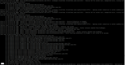

I found some errors in /var/log/hive. Not sure what to make of it.
Contributor
HTOP shows little memory usage

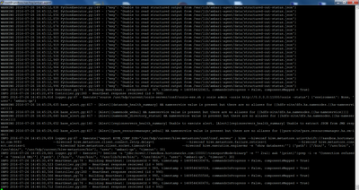

My AMBARI-AGENT.log show weird errors as well.

For the Hive errors, it's looks like hive is having issues communicating with Zookeeper. If Zookeper won't startup, then that's not surprising.
For the Ambari Agent errors, it looks like you have a corrupted json data file in your ambari-agent (/var/lib/ambari-agent/data/structured-out-status.json). Try moving the file to a different name like ".backup" and restart all of the services. I would do a "stop all" of the services, if it is available. Then try starting only Zookeeper to see if it comes up cleanly. After that, try starting the HDFS service. Then you can do a "start all".

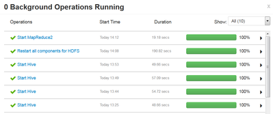

Contributor
WOW - I think backing up and deleting the file actually helped a lot - it's not perfect but it still works.
A lot of the services simply went green after i was able to restart zookeeper. So all services were running - Ambari is just unable to monitor them correctly. Unfortunatly ZOOKEEPER itself simply return to a red state - I need to dive the logs to find out what the next problem is.
