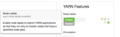

Does anyone have (or can you point me to) a link that explains the steps of using YARN node labels in HDP 2.3 being managed by Ambari 2.1? Our existing documentation is for manual configuration only. I've clicked the enabled button, and have already figured out that Ambari creates slightly different directory structures, etc. than are listed. I can keep going with trial and error, but if someone has already documented the process, caveats, etc. that would be fantastic. Thanks!

Thanks for asking this question. I could not find any specific docs and looks like it's straight forward from Ambari end ( as you said it already)
Under Yarn --> Config ( 2 features, Node label and Pre-emption - not relevant to this question)
enable label - yarn.node-labels.enabled
Doc mentioned to configure root-dir to HDFS but ambari has above location by default. We can follow the manual guide once enabling the labels through Ambari (Based on my testing in lab)
