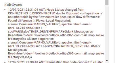

We have two node using embedded Zookeeper. The first node ran okay but the second node it always disconnects from the cluster with this error:
CONNECTING to DISCONNECTED due to Proposed configuration is not inheritable by the flow controller because of flow differences: Found difference in Flows: Local Fingerprint: s.email.ConsumeIMAPNO_VALUEorg.apache.nifinifi-email-nar1.13.210 sec30 sec1 secWARNfalseTIMER_DRIVENPRIMARY0Mark Messages as Read=truefolder=Inboxhost=outlook.office365.commail.imap.socketFactory.clas Cluster Fingerprint: s.email.ConsumeIMAPNO_VALUEorg.apache.nifinifi-email-nar1.13.210 sec30 sec1 secWARNfalseTIMER_DRIVENALL0Mark Messages as Read=truefolder=Inboxhost=outlook.office365.commail.imap.socketFactory.class=ja

Specific to your case we see the following difference:
Local Fingerprint (This is fingerprint of flow from node trying to join cluster):
Cluster Fingerprint (This is fingerprint of flow currently being used by the cluster):

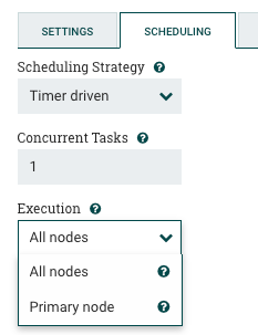

If we look closely we see that you have a consumeIMAP processor in your cluster flow configured to execute on "ALL" nodes.  On the node trying to connect the same consumeIMAP processor is configured to execute on "Primary" node only.
A common scenario where this can happen is if the node was "Disconnected" from the cluster and a user edited the configuration of this processor at that time.  Now that node can not rejoin the cluster because of the mismatch.   As other have said the flow loaded from the flow.xml.gz in to NiFi JVM Heap memory must match across all nodes.  Since all nodes run the same flow.xml.gz, you can copy the this file form any node connected to the cluster to the node failing to connect.
NOTE:  Understand that by this, you will lose those local changes made while that node was disconnected.
Another scenario is the configuration change was made while both nodes were connected, which means that changed was replicated to all nodes in the cluster.  If in your 2 node cluster only one node responded to that replicated request that the change was made, the node(s) that did not would get disconnected.  Failure to respond to a replication request can happen most often because of server resource issues and/or network issues.
