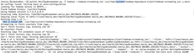

I am trying to execute a mapreduce function written in Python thru a Hadoop Sandbox via Terminal on MacOS.
I am connected to the sandbox (v2.6) via centOS which are all working fine.
The same python function runs successfully on my machine(locally) via Terminal.
Any clue as to how to fix this?
Many Thanks,
Z

There looks like a type mistake in your PATH Please check "haddop" .. it should be "hadoop" (The Jar name is not correct).
Your PATH:
/usr/hdp/current/haddop-mapreduce-client/hadoop-streaming.jar
The path should be
/usr/hdp/current/hadoop-mapreduce-client/hadoop-streaming.jar

Yes, you are right. Never imagined it would be a typo, thanks though!
