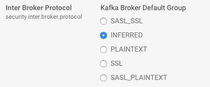

The problem I'm facing is that I'm unable to unset security.inter.broker.protocol through the cloudera manager as I only have the option of switching options in a radio button.
enter image description here
How can I unset that property?

Hi I know this is super late, but I was able to resolve this by doing this:
listeners=PLAINTEXT://0.0.0.0:19092,EXTERNAL://0.0.0.0:9092
listener.security.protocol.map=PLAINTEXT:PLAINTEXT,EXTERNAL:PLAINTEXT
advertised.listeners=PLAINTEXT://internal-broker-node-hostname:19092,EXTERNAL://public-broker-ip:9092
 I also changed the security.inter.broker.protocol to PLAINTEXT
