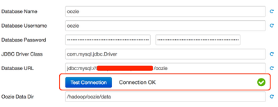

Same problem but more complex. Can you help me ?
  • oozie DB is created
  • user/pass and privileges are set OK
  • Connection test is OK
  • I can connect through command line from the same server emulating JDBC connector with sqlline:
# java -Djava.ext.dirs=/home/user/jline_sqlline__mysql_connector/ sqlline.SqlLine
sqlline version 1.0.2 by Marc Prud'hommeaux
sqlline> !connect jdbc:mysql://pro-hadoop-ambari/oozie oozie XXXXXXX
Connecting to jdbc:mysql://pro-hadoop-ambari/oozie
Connected to: MySQL (version 5.7.23)
Driver: MySQL-AB JDBC Driver (version mysql-connector-java-5.1.17-SNAPSHOT ( Revision: ${bzr.revision-id} ))
Autocommit status: true
Transaction isolation: TRANSACTION_REPEATABLE_READ
0: jdbc:mysql://pro-hadoop-ambari/oozie>
  • But ... the service doesn't start due to a JDBC error 😞
