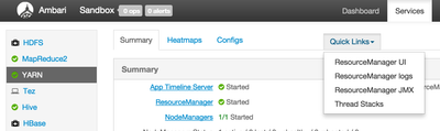

Launch Ambari
Click Yarn and quick links , click Resource Manager UI

@souvik majumdar
Launch Ambari

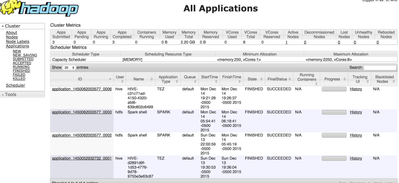

Hi Neeraj,
Thanks. Ifixed the issue. have I just went ahead and started the Hbase service and then it worked.
Master Mentor
Thanks @souvik majumdar. Just curious on how HBase start fixed the Pig job issue.
Well What I mean to say I could see many servers were stopped and I started them, one of them was HBase. not sure this one or some other restart solved the issue. What was your recommendation? I will follow that next time when I see this issue.
Master Mentor
@souvik majumdar I don't think starting HBase was the fix. There is a chance that HDFS or Yarn was down and you restarted those services. If issue is resolved then I believe we can close this thread.
