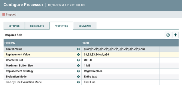

@sachin_32 ,
Here one different attempt. You can send your CSV flowfile to a ReplaceText processor with the following configuration:
The Search Value is the following regular expression:
(?s)^([^,\n]*),([^,\n]*),([^,\n]*),([^,\n]*),([^,\n]*)(.*$)
And the Replacement Value is:
$1,$2,$3,$4,col_a$6
Each capture group ([^,\n]*) will match the name of one column. If you want to keep the name of that column you just replace it with $x, where x is the position of the column.
If you want to replace the column with another name, e.g. col_a, you just type the name of the new column name in the replacement instead.
The last capture group (.*), will match the remaining of the first line. This way you don't need to match every single column, only the ones up to the position you want to replace.
As an example, for this input:
A,B,C,D,A
1,2,3,4,5
2,3,4,5,6
The above replacement will generate this output:
A,B,C,D,col_a
1,2,3,4,5
2,3,4,5,6
HTH,
André
