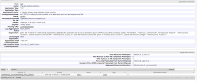

Expert Contributor
@Aditya Sirna
Attached image shows the application in accepted state:
actually I have created a new cluster but still facing the same issue.
sorry as I have deleted the cluster so I can not give you the log file.
Below is the image that shows the stack trace while i execute script:
As you can see in above image the execution is stop.
@heta desai,
Based on the log, your YARN Application Manager resource limit exceeded. You can try increasing "Maximum AM Resource" percentage in Yarn Queue Manager and see if it works.Go to Ambari -> Click on Views Icon (placed top right in UI) -> Yarn Queue Manager -> Increase Maximum AM resource by 10% and refresh queues.
