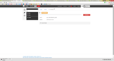

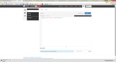

I'm running Hortonworks version 2.3.2 on VirtualBox, just following dadoop tutorial: how to process data with apache pig (http://zh.hortonworks.com/hadoop-tutorial/how-to-process-data-with-apache-pig/).
Have uploaded batter.csv file to the exact location as per the instruction, and just executed the simplest load Pig statement: batting = LOAD 'Batting.csv' USING PigStorage(',');
The job starts running, but never proceeds. Tried to kill the job, cannot either.
Could anyone please give me some hint of the possible problem.
Used to run the same tutorial last year on the older version successfully.

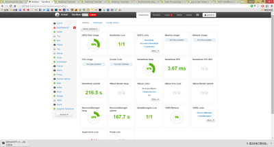

Couple of things to check
1) MapReduce - there is alert in your screenshot. Make sure that Core services are up
2) Another job is consuming all the cluster resources

Your mapreduce service is down or execute in pig ambari view with tez, check the box for tez. Start the mapreduce2 service first
