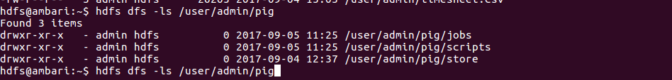

@Geoffrey Shelton Okot
Hello, i'm running the file in distributed mode through Ambari and the the command $hdfs dfs -ls /user/admin/pig returns results shown in "screenshot.png".
Mentor
@raouia kabadou
You stopped one directory short 🙂
$hdfs dfs -ls /user/admin/pig/jobs/ and NOT $hdfs dfs -ls /user/admin/pig
